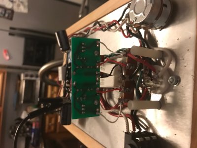

I was doing a voltage check on the small circuit board and i assume i (clumsily) touched the 237Ω 1⁄8W resistor (in R1A) cause I got a spark when I went to test 1A.  Turned it off just to make sure everything looked okay.  The fuse was fine.  Plugged it back in and got the following voltages

Was that LED lit up OK before this incident?
Can you post a photo of the PCB?

pretty sure but maybe somehow i didn't realize. see attached. let me know if you need more pictures!

Q1A is installed backwards.

my brain did not let me see that. thanks so much!
