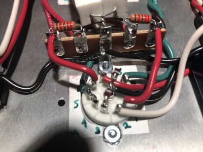

Just checked the wiring again. I have a slightly different wiring route for one of the power lines in that the wire that connects to A4 and A5 goes around the outside and under terminal strip 1 to 6 rather than follow the inside line of the terminal strip as indicated in the diagram but I wouldn't have thought that would have made a material difference. Thoughts.

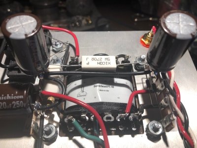

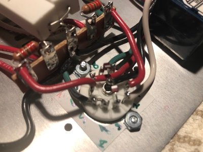

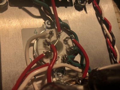

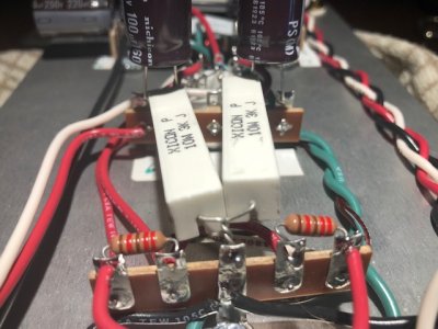

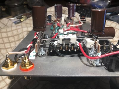

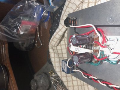

Offline niall lindsay
    • Posts: 10

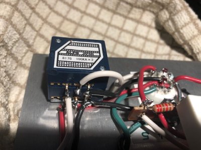

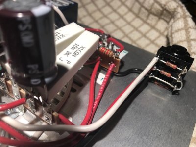

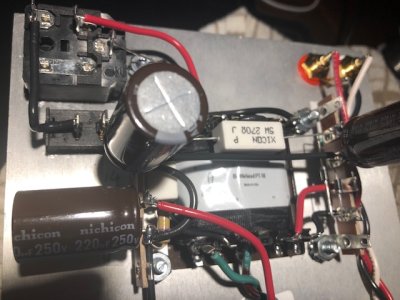

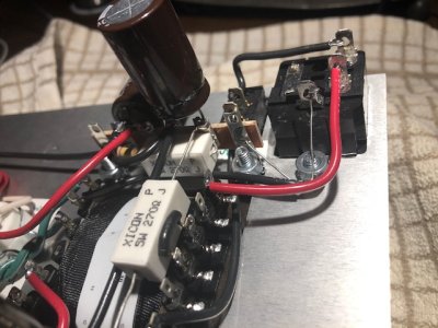

Reply #4 on: March 24, 2020, 01:35:18 AM
Paul
Some photos attatched as requested.
N

    • Posts: 20299
Reply #6 on: March 24, 2020, 04:49:19 AM
The routing of the green wires up at the 9 pin socket could indeed be a big part of the issue.
Notice that you have the wire going to A9 running in parallel with the wire going to A7?  That could induce some hum.  In the stock layout, the green wire is a bit shorter and it take a more direct route that's not in parallel with the signal carrying wire going to A7.  Having said that, however, noise induced in that matter should be influenced a bit by the volume pot, especially if it's all the way down.
Similarly the wiring going to A4/A5 could be causing similar problems.  These are difficult recommendations because even tidying these up, the hum may not change.
    • Posts: 10
Reply #7 on: March 24, 2020, 05:10:31 AM
Paul
Thanks for getting back to me so quickly. Yes the hum exists with no source plugged into the RCAs. Should l re-route the wire that is located on  the outside of the terminal strip to the other side as shown in the manual and also  try and create some physical seperation between A4/5?. The volume control plays no part in the hum it is just a constant presence and its volume does not rise or diminish with the volume control.

Deke609
Reply #8 on: March 24, 2020, 05:23:15 AM
You might also test whether moving the rca-to-pot signal wiring away from the transformer and diodes makes any difference. Maybe try moving the braided black/red/white wires about a 1/2 inch farther away. Worth a shot.
    • Posts: 10
Reply #10 on: March 24, 2020, 06:03:16 AM
Paul
I will reroute the green power line to the 9 pin socket (A4/5 & 9) to create greater physical seperation with the other wires and see if that makes a difference.
    • Posts: 10
Reply #12 on: March 24, 2020, 08:03:48 AM
Paul
You were absolutley right it was the parallell proximity of the wiring to A77A9 that was creating the induced Hum. Now totally silent.
