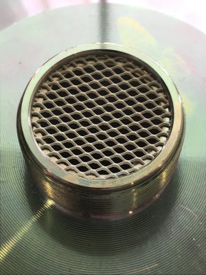

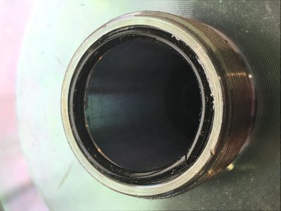

PJ (and anyone else interested ), here are the with/without grid plus O-ring photos:
Edit: The O-ring doesn’t look that dirty in a live observation. I guess I ought to clean those things with some alcohol, but I can’t get any at the moment. The stores around here are all sold out. F#*%+’n hoarders!

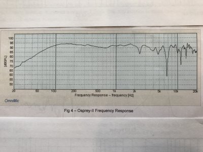

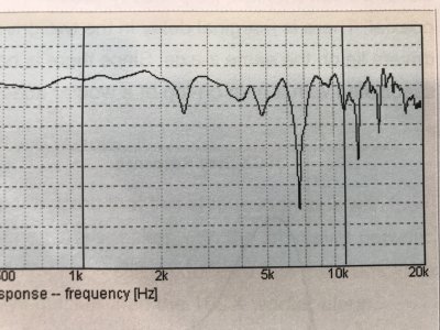

   Here is a photo of the system freq. response with the screens in. I don't have the ability to measure (yet), so I can't include a curve of the system with the screens out/O-rings in, but eventually I will.Does this look close to what you predicted? Since the O-rings don't fill the space perfectly I would imagine that some of the wobble is still present.
Edit: PJ, this curve was generated by the designer, Michael Chua at Ampslab.I failed to mention that in the original post. There are irregularities very near the frequencies you predicted, it’s just that they look like notches and I’m trying to understand exactly what’s going on.

PJ, I reread the description in your last post and I still don’t get it. The notches still don’t align with your description, for me, but the measured frequency irregularities are pretty close to your prediction, especially since 2.5 inches was an eyeball measurement. Is my tweeter acting like a Clarinet?
Jamie

Sorry for the confusion - I got carried away. The whole bit about low-impedance reflections and clarinets was an aside, not relevant to what I think is happening in your situation.
There are some peaks around my predictions but there are too many other peaks and dips for me to be confident of the interpretation. It's plausible at best IMHO.
If you get measurements with the screen removed, to compare, then we can see whether these peaks change and the others do not.
