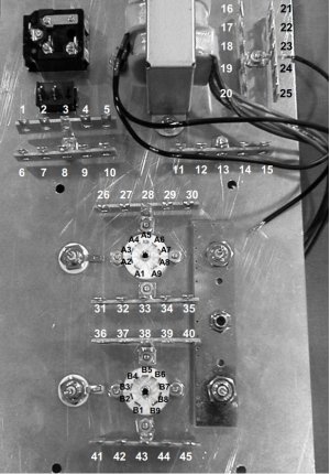

Here are the terminal numbers.  It's not completely necessary to measure the voltages on the tube pins themselves, as they are close together and there's some risk to shorting things out if you aren't careful.

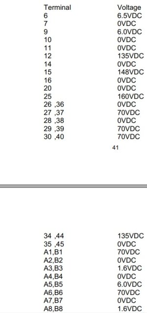

Here's the voltage list.

T12-125V
T27-92.5
T29-91.7
T30-91.5
T34/44-125
12, 34, 44 are probably within tolerance but I included them anyway.

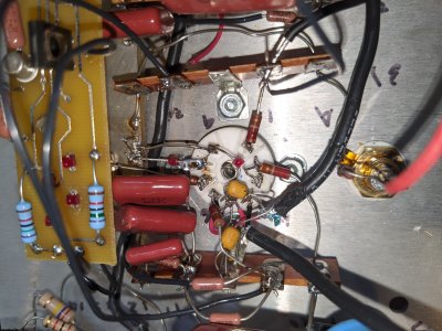

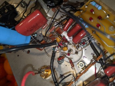

This may be one of the ugliest wiring jobs you have ever seen. Posting it here in case it's helpful.

You have a lot of parts that go through the pins of the tube sockets but don't wrap, that's risking poor connections.
Having said that, your voltage checks show that your tubes are conducting and functioning.  This is either a case of a shorted input/output RCA jack (you can check the DC resistance between the center pin and shell with your meter), or a short in the RIAA EQ that is dragging down the signal.  The short would happen because of leads touching each other that shouldn't be, and I do see some concerning areas in that build that could be causing that kind of problem.
