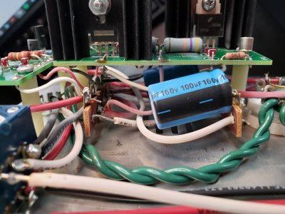

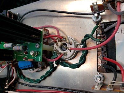

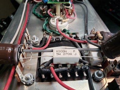

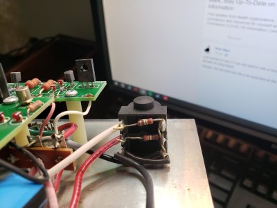

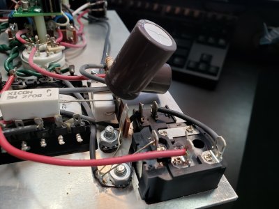

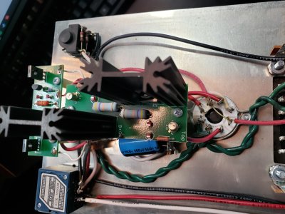

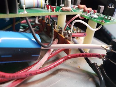

As promised here are some build photos. Let me know if any specific shots are needed.
    • Posts: 20204
Reply #9 on: April 11, 2020, 11:25:13 AM
I see lots of wires that are run straight through the terminal strips, then soldered in place.
To get a good connection, these need to be bent up and crimped around the terminal strip.  For the lower terminals, you can just bend the end of the wire up so that there's more area for the solder to contact. There's a red paragraph on page 21 in the manual that discusses this in more detail.

Reply #10 on: April 12, 2020, 12:55:28 AM
The red/black/white wires from RCA's to volume pot should be plaited together. This minimises noise pick up. Plaited not twisted. Details in the manual. Using the cutting lengths in the manual are a bit short if you do the plait tightly. I did and could have usefully have done with an extra inch on each.

Reply #11 on: April 13, 2020, 12:16:53 PM
Good call, Paul. My new tubes are on the way so if those don't fix it, my next step is to reflow everything, and during the process I'll get some better connections in those regions.
