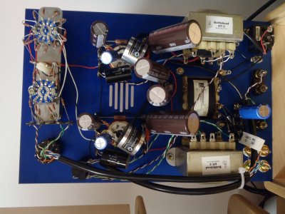

This morning I swapped my SEX3.0.1 into my office system so I can do some maintenance on my SEX2.1.1. (I listen to it all day, every day that I'm here) When I built the 3.0.1 it soon got the C4S board, while I never installed the C4S in the rebuild of the 2.1.1.
This is the closest to an A/B I've done and the difference is very noticeable. Not blessed with golden ears, I'll just say the grin was almost immediate. And part of the maintenance on the 2.1.2 will include installing the C4S board!
Thanks again Doc and crew.

The C4S is definitely a great bang for the buck. Quick question. Do you have stock interstage and parafeed caps installed in both of your amps?
    • Posts: 632
Reply #2 on: April 13, 2020, 02:17:37 AM
Clarity caps added. Both have stepped attenuators, documented earlier.
