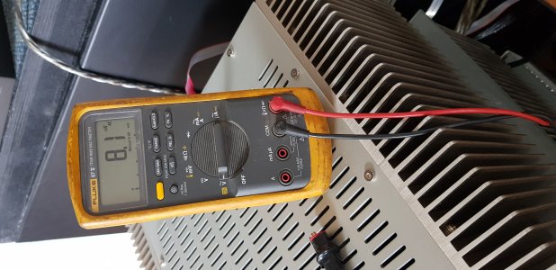

One thing I do notice, the hum test , on my measuring device is not stable and the values are not steady ,but changing erratically .At initial start up I hade 8.1mv on both channels, very steady.
However the Kaiju still sounds beautiful.

Hum test Right 8.1 mv.    Left 8.1 mv at start up o hours .

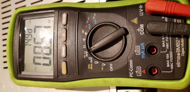

A small update ,changed my multimeter  and the hum value is stable ,a slight rise from 8.1mv to 8.5 mv all other values as mentioned in my first post are unchanged.
Thank you again for any advice. 🙂
