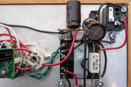

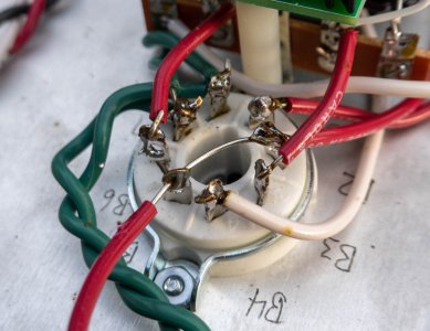

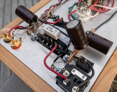

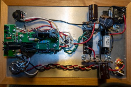

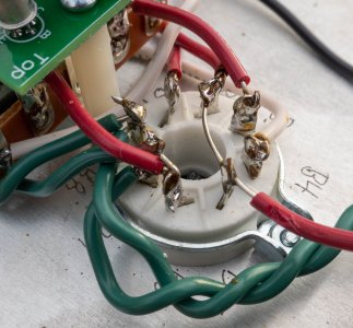

OK, I attach five images showing my skills...
Reply #5 on: April 15, 2020, 07:57:09 AM
I would go ahead and reheat all of the joints in the amp.  Just heat them up until the solder melts and starts to move around into all the nooks and crannies.
I would also be interested in seeing a shot of the wiring on your headphone jack.

I did reheat all of my "perfect" joints, and behold: the crackling disappeared completely! Sorry for bothering you; I had seen this advice on several other posts. Now the quarantine at home be less boring. Thanks, PB!
