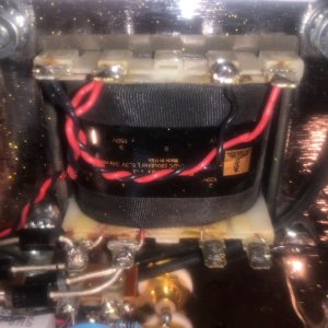

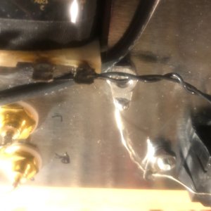

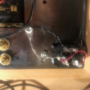

Transformer pins 1 and 2 should be connected to the power inlet socket and switch, which must be isolated from the chassis for safety. So something is not right. A photo of the transformer wiring might help.
I am also worried that both measure zero - there should be a few ohms difference between them. What resistance range was used for that measurement?

Thanks for the warning! So I went back and checked these again. I have an autoranging Fluke 179. In autorange mode and across all of the possible manual ranges, the meter reads "OL" at PT1 and PT2; this is the same if the meter isn't measuring anything at all, so I guess that is infinity rather than zero? If I measure resistance across PT1 and 2, it reads about 11 ohms. If I look for continuity between PT1 and the PEM with the power switch off, I find continuity with the black wire on the PEM but not the red or the ground; if the power switch is on, I find continuity with the black and red wires but not the ground. I see the same pattern if I test for continuity with PT2. I've attached pictures of the wiring the best I could take with my crappy iPhone.

Do your power transformer terminals read 0 ohms?

Reply #7 on: April 17, 2020, 07:04:07 AM
None of your power transformer terminals read 0.
Go ahead and power it up.
