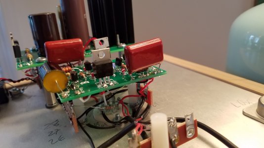

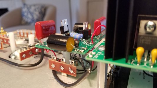

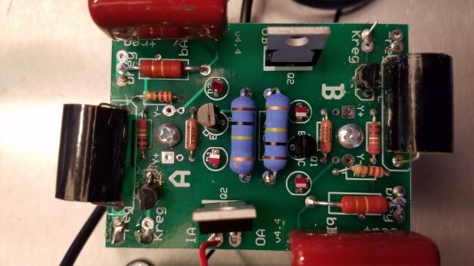

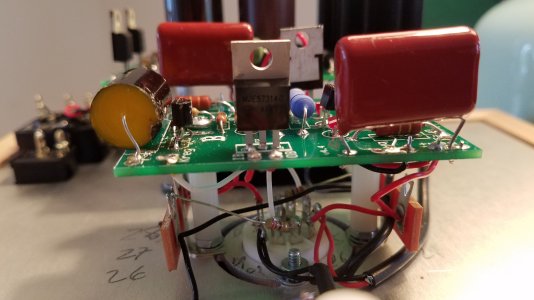

Reply #2 on: April 18, 2020, 09:39:22 AM
Thanks very much for the response Paul.
Here are some pictures.  The LM431 installations are a bit sloppy because I originally installed them backwards.  Please let me know if another view would be helpful.
    • Posts: 20250
Reply #3 on: April 18, 2020, 09:44:55 AM
It's somewhat likely that you should plan on tossing those 431s.  In my experience when they get damaged, they will tend to semi-short out internally and can show that random 1.8V voltage across the device.  If those have been heated up a bunch, that could be the problem that's at work here.
When dealing with replacing those, a spring loaded solder sucker is pretty useful for removing the solder on the board.  Solder braid is also adequate for this work.
