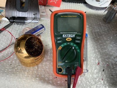

Are all of the DC voltages correct?  If so, can you post a photo of your meter, then I can give you some instructions to follow signal through the amp.

Sorry to be thick, but which meter? The amp’s meter or my DMM?
