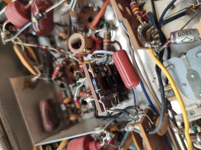

I have worked on electronics built 50+ years ago that were "all good" but had joints that weren't soldered or weren't well soldered.  I've attached a photo of a Fisher 500C receiver that I went through and restored, then took back in to do some other mods.  I spent hours working on this thing and missed that bunch of diodes were never soldered back when it was originally made.  It worked fine, but I definitely soldered in those diodes!
When you put the Speedball in, you disturbed and moved connections that wouldn't otherwise be disturbed or moved, and this can introduce new problems.
