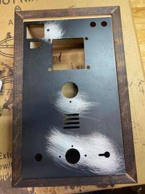

So I realized I painted the wrong side of the top plate.  I then painted the other side.
Now I read the manual and it says to leave the bottom side unpainted.  Do I need remove all the paint?  Do I need to remove paint in specific areas to allow for appropriate ground?

You should remove paint in these areas:
1.  Where the volume pot mounts.
2.  Where the 5 lug strip mounts by the 9 pin socket.
3.  Where the #8 grounding screw mounts by the IEC power entry module.
When you paint the correct side, you'll also probably want to pass a 1/4" drill bit through the holes for the transformer screws, as there will be two layers of paint there that will make fitting the hardware difficult.
I would also like to thank you for being thoughtful about your project and correcting the issue before proceeding with your build.

  Thanks for your quick response.  I think I got it.  I tried to post a picture but I can’t yet  :o
Mike
    • Posts: 20299
Reply #3 on: May 08, 2020, 07:54:56 AM
There's a file restriction size, so often photos have to be scaled down by about 50%.

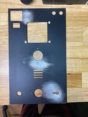

Found it
    • Posts: 20299
Reply #5 on: May 08, 2020, 08:01:14 AM
You sanded the paint off where the 5 lug strip mounts by the octal socket.  You need to sand the paint off where the 5 lug strip mounts by the 9 pin socket.
Offline Bullpride
    • Posts: 33
Reply #6 on: May 08, 2020, 08:13:50 AM
...and that's why we post a follow up. So close yet so far away.
    • Posts: 20299
Reply #7 on: May 08, 2020, 09:22:15 AM
Looks good!
