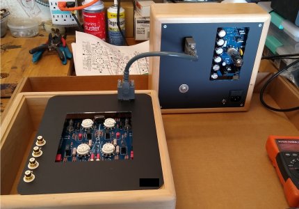

Both my Bottlehead based home systems include vinyl playback, driven by an Eros and an integrated Reduction. I always read about systems describing "black background" with envy and some sense of failure. Both systems use short, decent cables and neither exhibit hum nor mains noise; but there is certainly not a black background. There is a difficult to describe low-level background hiss/buzz audible within about 6" of my speakers and in my headphones. It does not exist when using my solid-state phono preamp or a digital source.
As an experiment, a very expensive experiment, I built a respected board-based tube phono preamp. I built it "BH style" to drop into my systems, but with the PS in a separate, shielded enclosure.
Either I made the same mistake 3 times (actually 5 if you count the 2 rebuilds of my Reduction) or there is just some level of audible noise associated with all tube phono.
What is considered an acceptable level and how do I measure it?

Tubes generate something called 1/f or flicker noise. It's pink noise, a sort of "dull" static sound. It's an inherent characteristic of a lot of electronic devices. What you have to do (besides sitting more than 6" from your speakers...) is address the signal to noise ratio of the system. A higher output phono cartridge or LOMC with a larger ratio step up device is the way to accomplish this. More output from the cartridge means you turn the volume knob down, and hence you lower the noise floor.
This is why we specify a recommended minimum nominal output level for the phono cartridge used with our preamps. Minumum is 3mV with 5mV being optimal for the Reduction. One can get away with around 2mV with the Eros, but in any case a higher nominal output will always result in better S/N.

The pink noise description makes sense with what I hear. I'm using a 2M Blue and Red, so plenty of output. And I do sit 6-9 feet back so it is really a non-issue with the speakers.
