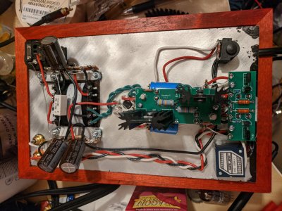

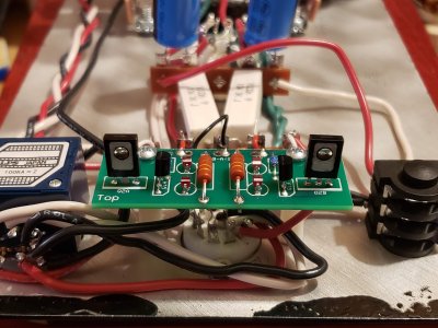

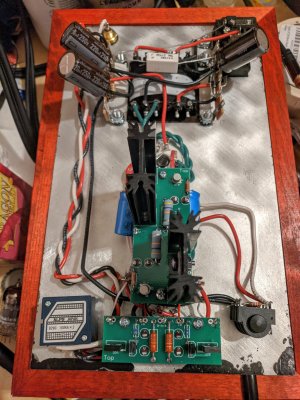

Otherwise I'm quite happy with my build so far (and yes I know, mirrored is highly discouraged, but it's working and wired per the manual), need to apply more sealcoat to the wood to get some gloss going, but I'm super stoked with how the stain turned out (picture makes it look more dull than it really is). Paint on the top plate has a couple of blemishes but ah well, I can live with it. Attached some pictures for review, since then I've changed the RCA cables to ones with 90s on one end, looks much cleaner though did nothing really for the sound.
