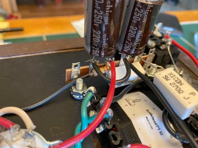

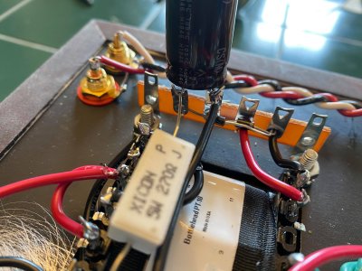

Can you post your voltages and some photos of your build?
Offline Bullpride
    • Posts: 33
Reply #4 on: May 14, 2020, 05:57:39 AM
Forum is being weird about posting picture right now.
Offline Bullpride
    • Posts: 33
Reply #5 on: May 14, 2020, 05:59:03 AM
one at a time apparently ha
Offline Bullpride
    • Posts: 33
Reply #6 on: May 14, 2020, 06:05:09 AM
Offline Bullpride
    • Posts: 33
Reply #7 on: May 14, 2020, 06:28:23 AM

So, if you look at a joint like 12U, that's just not soldered.  I can see the entirety of the black wire going through that upper hole, and there doesn't look to be any solder on it.  This same issue is present where the UF4007s mount, the ground tab on the black RCA jack, 3L,
A4/A5 looks like a place where you need to remove a bunch of solder.

Cleaned up a few joints and added solder that I missed. Full set of updated pictures at the following link.
https://imgur.com/a/ztdsi6V
