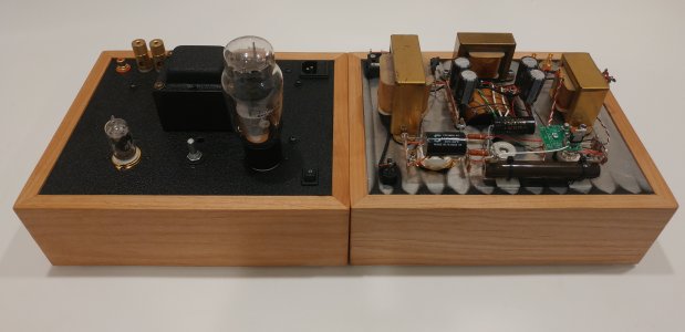

My husband bought 1970's Klipsch La Scala speakers in 1995. We divorced in 2010 and the speakers lived unused, in my my basement for 10 years. I brought them up, had them checked out and they sound great. I have no amp. My friend found Bottlehead amps and a matching preamp near me and told me they would be perfect, so I bought them yesterday. The guy that sold them to me bought these from the person who built the kits. His original pieces (2 amps and preamp) -the preamp developed a hum, so instead of fixing, he bought another Bottlehead preamp. I bought the 2 amps, and the 2nd preamp, and he threw in the preamp with the hum, and suggested I get it fixed. I hope I did the right thing :) I am 66, and have no mechanical talent. How do I get it fixed? What should it cost? How can I tell which preamp I should keep? Should I keep or sell the 2nd preamp? Will I be able to sell the 2nd preamp? Also, I don't think there are enough (inputs? outputs? (whatever you call them) for turntable - do you have suggestions? I've attached some photos. Any an all suggestions welcome. Thank you. This is like buying a car when you've never driven one .... :)

Wow that's some really vintage stuff! The two boxes in front in the first pic are preamps, our Foreplay preamp from the 90s. You are correct that the Foreplay preamp does not handle a turntable directly. For that you need a separate phono preamp that goes between the turntable and the Foreplay preamp. We sold a phono preamp called the Seduction back then. It has since been refined and is now called the Reduction.
The two boxes to the rear in the first pic are the amps, one per channel. Those are Paraglows, the same vintage as the preamps and a good match indeed for La Scalas.

For some reason, I can't see your photos (apparently Dan can, which is helpful).
You're going to have a hoot with some old Paraglows and those Klipsch speakers.  The repairs that roll through Bottlehead all hit my bench.  For an old Paraglow, I like to put in a very different power supply and a more substantial cathode bias resistor for the 2A3s to tame the heat that those amps generate a bit better.  This is a little bit beyond our flat rate repair service, but not by a whole lot.  (I believe $350 the pair plus shipping boxes to you, you shipping amps to us, and us shipping amps back to you).
I can also gut old Paraglows and repackage them into a pair of bigger 8x10 plates and bases.  In this configuration, I use an even large cathode bias resistor that runs really cool, and everything is super spread out on the inside.  It's somewhat over the top, but these old amps are pretty special! My pair of Paraglows is done up just like that.

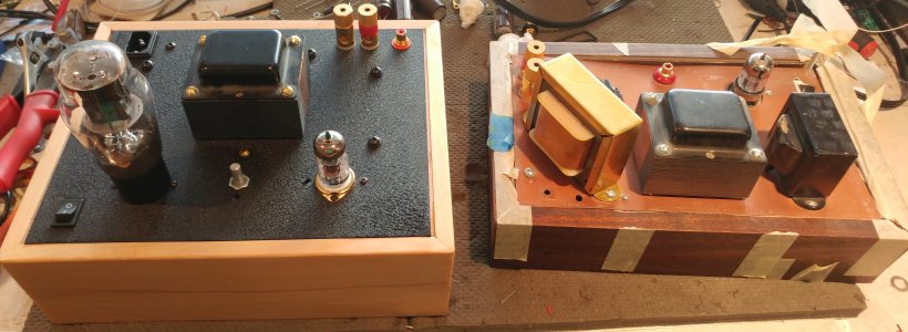

The Speco output transformer suggests that these are Paramours, not Paraglows. Also the lack of a flux band on the power transformer. If the large black transformer in the middle has a label on its back side (right side from the first photo) that would confirm it.

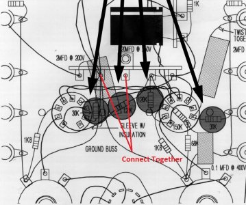

There was a common mod that was done to the Foreplay I and II that reduced hum in a fair number of systems.  I can dig up my old manual and make a little picture if you would like to see what that looks like, as that may need to be what's done to the humming preamp.

Before you pull the trigger on a flat rate repair, this is the modification that may be present in one of your Foreplays but not the other.

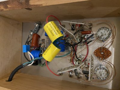

I don't know how to read a schematic. Sorry, the photos were in the correct orientation when I uploaded them. Don't know why they rotated.This is the preamp that hums.

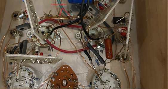

How about this?

Most of our customers build these as kits, and are glad to fix things themselves with a little help from the forum, and save some money. But in your case, that's only possible if you have a technician or knowledgeable friend readily available, and it still means arranging the work and transportation etc. (The repair service is $125 plus shipping one way, and it's possible that the only thing needed to quiet the humming preamp is to connect two terminals.)

Paul, so all that this preamp needs is that one wire and the humming will stop? Is it currently a foreplay 1 or 2? Does that wire have a name? What else do I need to know? I've never fixed anything in my life, but maybe I can find someone to help me? Do I need a schematic? How much is the schematic? Thanks.
