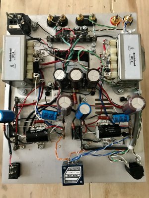

In case it helps, here's a picture of my build.

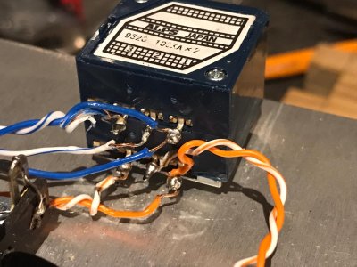

Maybe its just the angle of the photo but I do not see anything connected to the wiper of the alps pot (pin 2)
This is what feeds the voltage amplifier grid of the 6fj7 pin 10 on that tube.

Hello and thanks for your reply. I think it is the angle of the photo. Both wipers are connected to pin 8 on each side. Do you think I should go back to the stock pot?

I'm sure you can use the Alps pot but I feel that the circuit may be miss wired. please check that the wiper of the pot is soldered to pin 8
of the 6fj7 socket and the grid stop resistor. then make sure the grid stopper resistor is connected to pin 10 of that socket.
pin 8 is an unused pin for that tube that makes it a convenient mounting place to mount the grid stopper resistor. Having said that I still feel that perhaps your volume pot may be miss wired so perhaps a few more photos of the pot showing the connections to the pins could be useful.

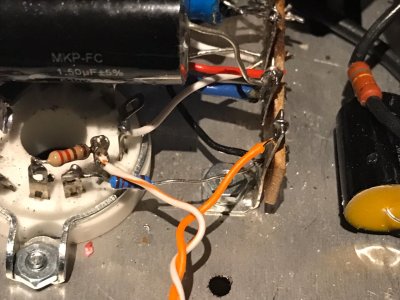

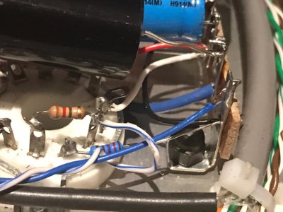

Thank for answering, here are some more photos
