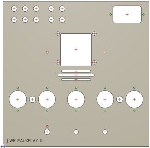

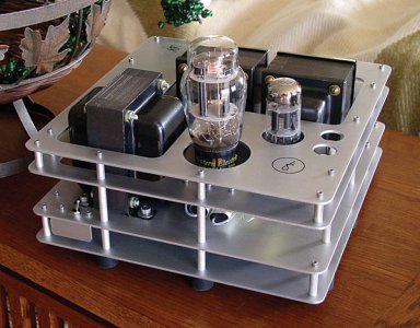

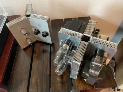

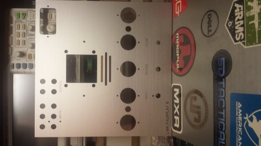

Did I mention this may be long? So I think I have all the parts amassed and have designed a preliminary chassis plate using Front panel express. I have some nice curly maple lumber on hand for the base, it has a really nice grain. Attached is a screenshot of the chassis as it stands now. It is 10x10 inches to accommodate the extra tubes and a couple of pics of Don Garber designs.

In front panel express, if you have something like a 2.5mm thick panel, you can run a cavity down the top of the panel that is 1.25mm deep and 1.25mm wide, then when you get the panel it's very easy to bend by hand where that cavity is.
On the downside, the anodizing will crack on the outside radius of the bend, but that would otherwise be buried in your chassis anyway.

Reply #2 on: May 20, 2020, 06:35:15 PM
Thanks PB,
This panel is 2.5 mm and I understand your point but as much as I would like to do something like that, I feel like the build will be to problematic for me at this time but I may reconsider. FPE uses a 2000 series aluminum and I need to research  the properties of this grade of aluminum   I have used their products in the past on many occasions and I have been happy with their manufacture. I would love to do a Garber inspired design but the cost of FPE is quite costly and I would hate to throw those bendments into the scrap bin. Having said that as I stated before I may reconsider. I am pretty confident that I can build the circuitry and the mods I would like but I will probably need some input in the future, so if you and PJ can keep an eye on this post I would appreciate it.

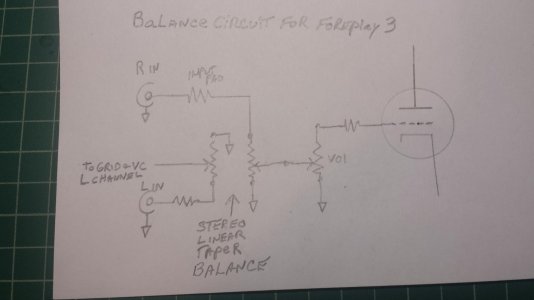

I would like to use a stereo pot in lieu of a stepped atten. I have a 20 k and a 10 alps pot and want to use a balance pot.
see attached drawing showing what I propose, I would like to keep individual padding resistors.
keep in mind the drawing leaves out the input switch and only shows one channel but shows how the bal pot is wired.
Hope I did not confuse you to much. any thoughts will be greatly appreciated.

    • Posts: 20300
Reply #7 on: May 22, 2020, 02:06:04 PM
The exit of your balance pot needs to go to the input of your volume pot, not the wiper.  The wiper would go to the tube grid.

On the Fp3 the input to the stepped attenuator is the wiper. this is not a conventional method but if you look at the FP3 sch. the input to the volume stepped atten is the wiper and the out to the grid is one leg of the resistor series and the other leg is ground. I suppose I should wire the vol pot with wiper to grid as is normal and that would work  as I am not going to use a stepped atten  but a volume pot Thanks for the reply.

Reply #9 on: May 23, 2020, 08:31:06 AM
The FP-3 didn't have a balance control, so that kind of arrangement wasn't problematic.  If you wire up what you have drawn, the left to right balance will change substantially as you move your volume pot, which you don't want.

I think I see your point, if I do, than I will run the balance pot as I described and feed the wiper of the bal pot to the end of the resistance track of the vol pot and use the wiper of the vol pot to feed the grid as is in a normal config. Any suggestions as to the value of the bal pot? I think I have a 50k linear somewhere unfortunately I need a shovel and a rake to sort thru my tightly controlled inventory system. and this is stuff that I am currently engaged in. I have several other piles in different rooms. I am ashamed actually. see attached. lol.
    • Posts: 20300
Reply #11 on: May 23, 2020, 03:32:13 PM
Sure, 50K is a value that could do the job.

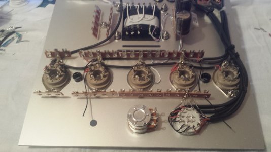

Ok, the ball is rolling.

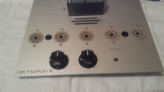

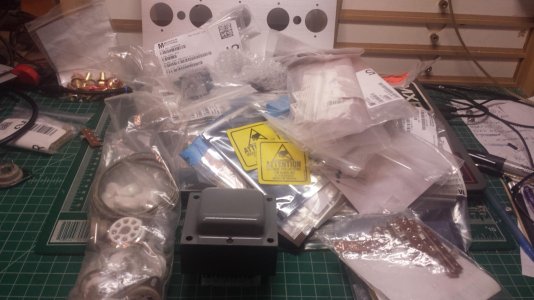

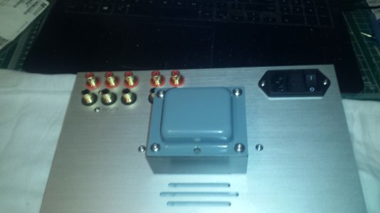

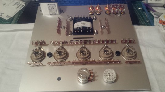

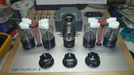

FPE arrived this morning, now all I have to do is figure what all this stuff is! I installed the chassis parts. I am not sure what
I will use for a VC, I have a few options. Stay tuned for the next exciting episode of this adventure. Same Bat channel

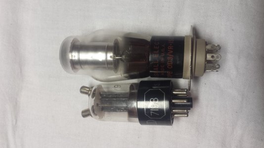

Tube compliment, 4x 7193 and 0D3 for now.

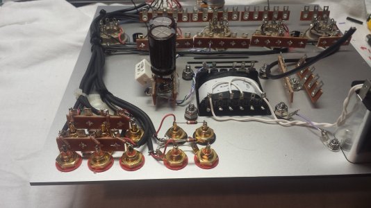

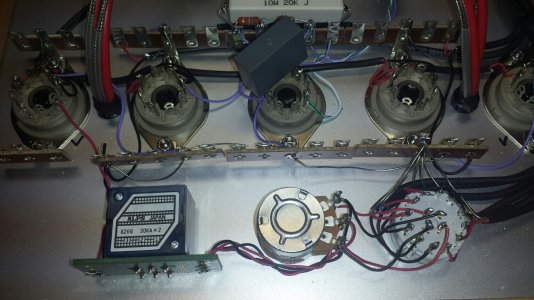

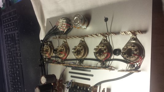

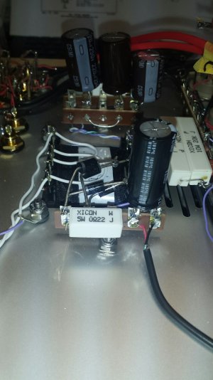

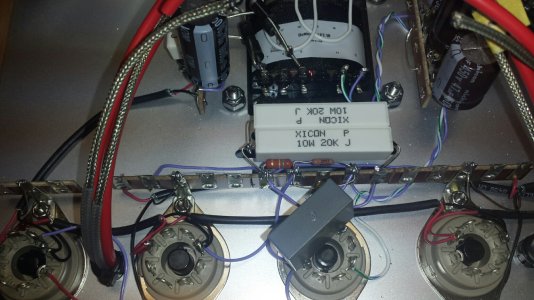

Ok todays progress.

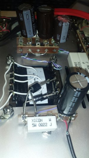

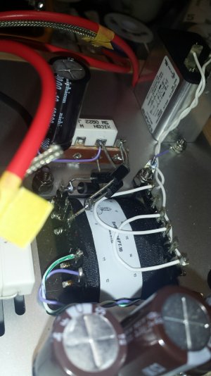

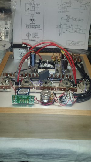

Wired the PEM to the PT-10 and completed the HV supply. Inputs are done, I decided to place the padding resistors at the rca's on terminal strips. Outputs partially done. Wired the tube sockets for the DC heater supply except the ground reference. That's about it for today. Peace out, stay well, stay tuned.
