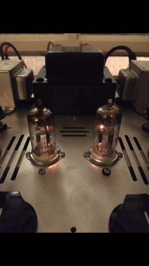

Thanks for the input. I do NOT have the SR. I switched tubes again and get the same result. When the “bad” tube is on the right channel there’s no sound and the glow is a different/brighter color. It also doesn’t feel warm like the other tube. Again, the light gets particularly brighter on that side when I turn the volume down and I here a mechanical twang when I turn on the amp with the tube on that side. Picture shows the “bad” tube on the right
When the “bad” tube is on the left channel everything sounds normal and the glow looks more or less the same. The two 12AT7’s I received look very different, so maybe one was on the way out?

     I hope I didn’t confuse the situation, but it is possible that you have a 12AT7 that is going bad on one side. As PB said, check your connections carefully, but it is possible that 1/2 of that tube is problematic and may be the source of your problem. Do you have any other 12AT7s to substitute? When you trade the 12AT7s you are using the side of the tube that was inactive when it was on the other side of the amp. That is why I’m suggesting that the problem is, possibly, the half of the tube in question.

Nope, not confusing at all. I totally get it. I think especially given that the same behavior is replicated only with that particular tube in the right channel is a good indication that you’re correct. I will recheck all connections tomorrow, of course, but I don’t see it being a loose connection that happens to work with one particular tube and not the other.
Unfortunately I don’t have spare tubes laying about, but this seems like the best explanation.
Is it safe to run the amp with a tube that has failed on one side? It sounds totally normal as long as I have that tube on the side of the amp where the problematic side of the tube isn’t in use.

What Jamie said. One triode uses pins 1, 2, and 3 for one channel; the other channel uses pins 6, 7, and 8 on its 12AT7. This is done so that if one triode fails you can swap tubes and use the other triode. Which you did, and apparently it's working. It's like having a (full-size) spare tire in your car!
The second triode in each 12AT7 is only used with the shunt reg kit.
So now you have music again, and plenty of time to acquire a replacement spare 12AT7.
