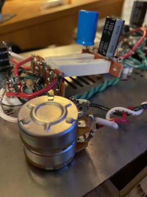

I think I may see where the problem is. I took new readings. It's showing the left channel as having slightly higher voltage though. And after re-looking at my solder job it possibly could need re-done at the top middle joint on the pot (left channel joint). I've attached a photo.
I'm testing at AC Volts (V~). Amp is powered off, tubes are still in.
At volume in the middle I get 0.104V for the left channel (white) and 0.094V for the right channel (red).
At full volume I get 0.634V for the left channel (white) and 0.633V for the right channel (red)
The reading is taken at the middle lugs on the volume pot.
The reading at the RCA inputs is 0.633V (white) and 0.634V (red)
I notice when i put the clip on the top middle lug (white) I get a less consistent output. it shoots up to 0.186 to 0.201V sort of randomly unless I adjust the clip. I've attached a photo. Looks like maybe that middle top lug could use re-soldering?

Yes, in your photo the white wire in the top middle lug of the volume pot isn't soldered.
If there are any other joints in the amp like this, they need to be reflowed.
In the meantime, if you turn the volume pot all the way up, what AC voltages do you get at the middle lugs on the volume pot?
