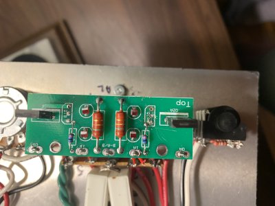

Already tried and failed. I just emailed to order a new pair. Oh well. Is it possible that I damaged the eyelets where the three prongs are soldered in? I kept trying to heat up the joints to pull them out and fear I heated them for too long and possibly damaged the circuit board. I’ll post a photo.

here's a photo  :-\

Reply #6 on: May 29, 2020, 08:35:21 PM
Q1A looks OK. Q1B is a bit suspect, but it's impossible to tell for certain. Buy some solder wick and use it to clear the solder away from the board.

Reply #7 on: May 29, 2020, 08:54:45 PM
I’m surprised you said Q1A looks Ok and Q1B looks suspect. Q1B I didn’t fully clear out yet/middle and bottom lead I think are still soldered in there. I got frustrated after my failure with Q1A and left Q1B alone until later. I needed a break.

Reply #13 on: May 30, 2020, 07:43:55 AM
What I really meant to write and then didn't is this. It looks to me like you may have damaged one solder pad at Q1A, not Q1B. Once you have cleaned things up you should take a close look at the solder pad next to the edge of the PCB at Q1A.
