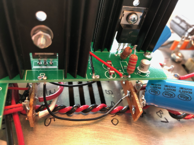

Hi everyone.
I built the standard crack about a month ago. Build went smoothly, all resistances and voltages checked, been working perfectly. (Love it)
Built the speedball upgrade today and I've had a few issues. I also added padding to the pot during at this time.
- Had a shoulder washer backwards on one of the TIP50 transistors, fixed this rigth away.
- Foolishly connected the black cable (that runs from 3U to right side board terminal G) to the terminal above G (directly beside the 2907 transistor). I correctly this as well.
Current Issue:
- As far as I can tell theh LED's on board B (right side) do not light up. It is difficult to tell given how dim they seem to be.
- Voltage on Terminal 5: ~150
- Voltage on Terminal 9: ~150
Thus far I've reflowed most of the joints on board B, in addition to Terminal 9, and several joints on the large PCB. I've searched the forums and seen similar voltage issues in a few posts but I'm unsure where to go from here. I'm wondering if I blew a component with a previous error. Any help would be appreciated.

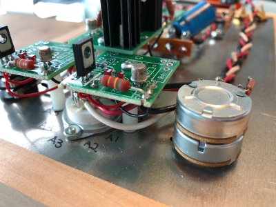

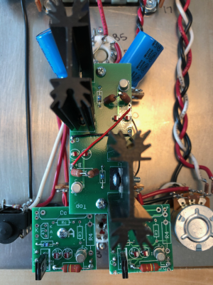

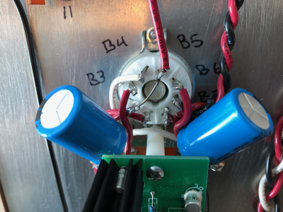

Offline tchevy
    • Posts: 18
Reply #1 on: June 04, 2020, 03:25:58 PM

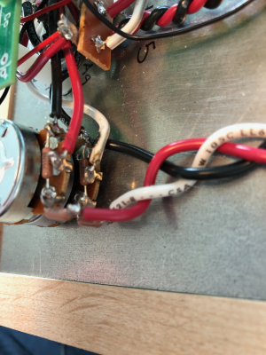

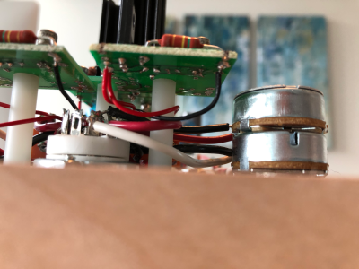

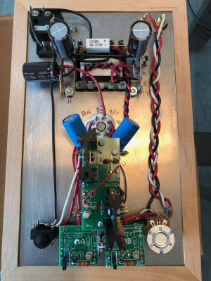

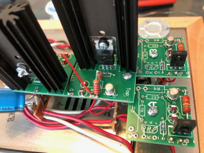

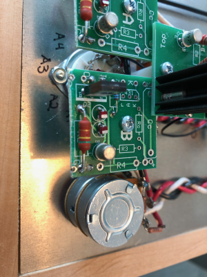

Pictures.

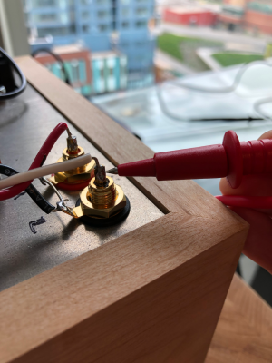

- When measuring the voltage on TRS jack while starting up I dont see the voltage change at all, just stays at 0. I am measuring this gold portion of the tip. I think this is how I measured it previously. Is this correct or am I out to lunch agian?

As far as the voltage spike goes, wire all three outer headphone jack terminals together, then there won't be any spike at all.
