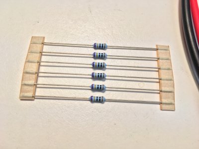

I just finished assembling my new SEX amp and there are a few of my resistance readings I want to check with you all before proceeding to the voltage tests.  On terminals 30,31, & 32 I get 215 ohms.  And on terminals H2, H4, H5, & H7 I get 214 ohms.  Is that ok, or did I screw something up?  Also, I got to the end and had six 100K ohm resistors left over that I didn't see any place for.  Am I getting these numbers because those were supposed to be installed somewhere?

Can you pop up a photo of the 100K resistors?  My guess is that those got swept into your kit by mistake.

Sure, here you go.

That's really odd, that doesn't look to be a part we even keep in the inventory.
