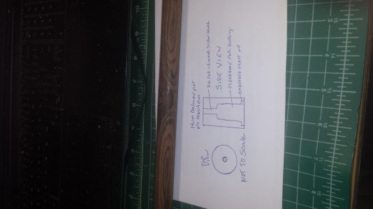

Hey Jameson, My favorite whiskey by the way,
Have fun making custom wooden knobs, lots of good advice here on this thread. Here is another thing you can do if you have any amps with an exposed hum pot, make a cover with a small hole for a trimmer screwdriver. Granted it would be convenient if you had a lathe or a friend who has one. I just got a Bocote hardwood dowel expressly for that purpose. Excuse the poor drawing.
