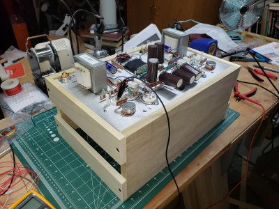

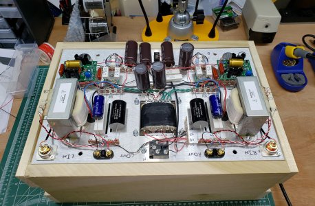

Despite a promise to Queen Eileen that I would be patient in building the Kaiju that arrived on my doorstep on Monday, I haven't been able to help myself and am deep into the build. I've attached a photo showing the jig that I built to help me in assembling the Kaiju. The building jig is tall enough that I can test the circuit with the 300B's installed and the whole thing inverted without any risk to the tubes or the newly painted finish of the transformer bell. This photo was taken just after the kit successfully passed its high power voltage supply voltage test with the 300B tubes installed. Yay!

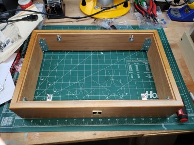

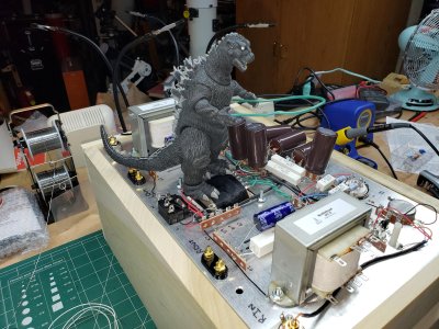

Inspired by photos from the Kaiju instruction manual, I had Godzilla help with the build! The rest of the build went very smoothly. Given how heavy the amp is, I decided to secure the wooden base to the chassis plate, so added some angle brackets and mounting bolts. Also reinforced the corners of the base, "just for good measure." This was a longer and more involved build than the other Bottlehead kits I've put together, but I enjoyed every second of it!

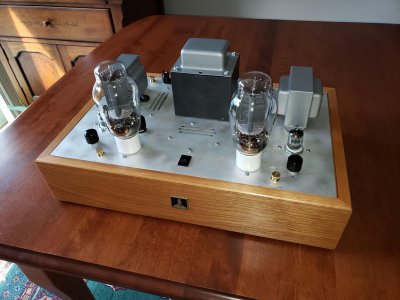

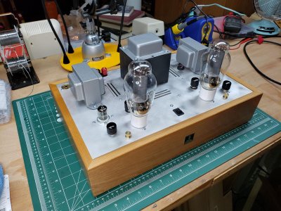

Another Kaiju lives! The completed Kaiju sounds great! When used with 96 db Klipsch RP-600M speakers I did notice some hum. I didn't notice any, however, with my 88 db efficient Dynaudio Excite X38's. When adjusting the hum pots, I found that the lowest hum I could achieve was 8.8 mV, which was above the 5 mV target mentioned in the manual. However, the amp sounded just fine when actually playing a source, so I figured that the hum being a bit high was a non-issue and probably idiosyncratic to my tubes. After listening to the stock Kaiju for a day, I then added the DC filament upgrade. The hum completely disappeared, and the hum I measured as now being only 0.5 mV. Adjusting the hum pots after installing the filament upgrade seemed to have little actual effect. Is this normal?
