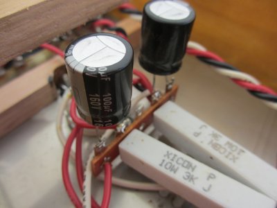

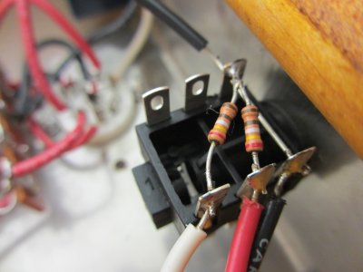

I've opened up the case and visually inspected the 2x 100uf 160volt capacitors and could not see any signs of leakage or brown/burn out or bulging. I've also checked the solder joins at the headphone socket and volume pot and also around the tube sockets and nothing loose and I have even touched up the solder joins in these areas.
HOPING someone here can provide some advice/help on how to troubleshoot this further ?  Could it be those caps or maybe those 2.49k ohm resistors in headphone socket that's gone bad ?

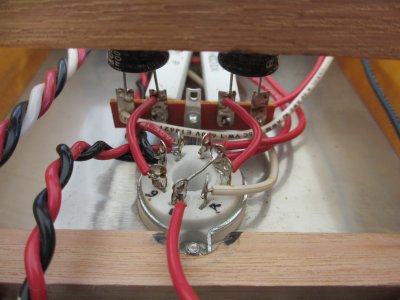

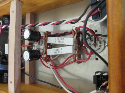

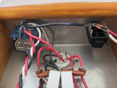

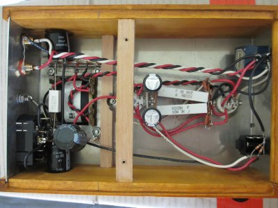

You would need to start with the voltage check in the manual.  Can you post a photo of the entire bottom of the amp?

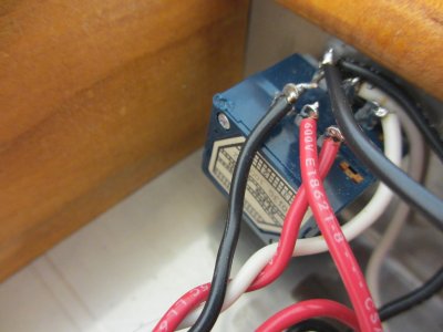

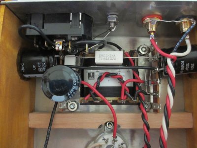

Please see additional photos of the insides of my Crack amp and yes, this is a custom top and base that was made at the time of building this amp kit.

Another thing that I notice is that you've soldered wires right to the Alps Blue volume pot, which often causes the pins on the pot to break off.  If that happens, it will often manifest in weird voltages.  Don't feel too badly about that though, I just opened up a very high end Japanese preamp in a beautiful pair of green boxes today with an Alps blue with wires soldered to the PC mount pins.

I guess I have been lucky to this point in regards to soldering the hookup wire to the pins on the ALPs pot. You've made a good point and I never thought of it that way and at the time I was
just begrudging that ALPS don't have this type of volume pot with solder lugs  ::)

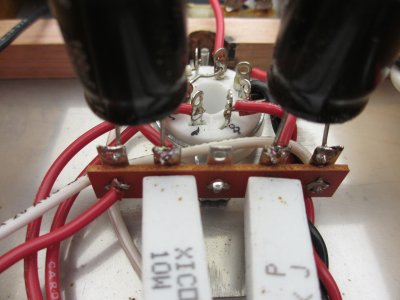

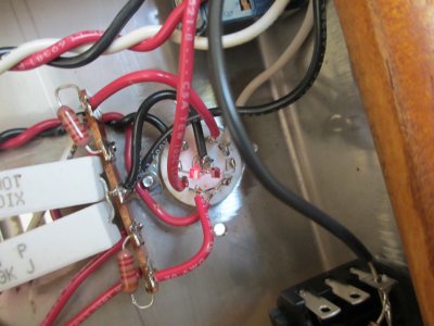

If the wire connected to A4 is not well soldered, then only half of the 12AU7 will glow and one LED will go out.  This will also be indicated by 0V on A3.
That wire does not look well soldered at A4, nor does it look all that well soldered at A5.

Thanks for that suggestion Paul and I have re-tinned/soldered up A4 & A5 and took the opportunity to re-do A3 whilst I was at it as that looked more "suspect" than A4 & A5.  No change, A3 LED is still not lighting up at all.

Since you have 0V at A3 and ~150 at terminal 5, the tube is not conducting.  The most common cause for this is that A4/A5 solder joint, which I will emphasize again, and also double check that by both halves, I don't mean a glowing dot on the top and bottom of the tube, but a glowing dot on both of the internal plate structures inside the tube.
If it's not that, then the wire going to A1 could be broken or just not well enough connected to conduct.
