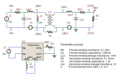

If these are custom made, there may be an ERS (Engineering Requirements Specification), or similar, that informed the vendor about what to build.  Barring that...
The individual windings identified (e.g., transformer has three windings, around a common core)
Number of turns, each winding
Inductances and DR resistances for each winding (L, in henries and R in ohms)
Leakage inductance
The magnetic coupling between windings (K in unit-less fraction where 1 is perfect coupling and 0 is no coupling at all).
Parasitic capacitances (in farads)
Core type identified (e.g. E-I or toroidal).
Image, attached.
Thank you
Vince

With a zero feedback circuit, that level of information is overkill for a Spice simulation.  Some of what you're asking for is similarly completely irrelevant to creating a circuit simulation.  Beyond that, a fair amount of what you're asking for is available in the manual for the Kaiju as well.

It may be overkill, I do not know.  I am trying to learn the craft.  Sometimes this results in mistakes.  Removing a parasitic part from a simulation is as easy as typing "* ".
Perhaps would would be so kind as to show me where, in the manual, the references are.  Searching for the strings, "OT-5" and "PC-5"  I find no values in henries or farads.  The ohm values are related to speaker impedance.  Am I missing something?

The schematic tells you the inductance of the PC-5.  The voltage checks at the end are enough to get the DCR of the PC-5 as well.  The inductance of the primary of the OT-5 can be measured reasonably easily since you do not need to apply a DC current to get reliable results.  You'd need a reasonably potent signal generator, a DVM, and a 100K pot.
PJ may have an estimate of leakage inductance and interwinding capacitance to use for your model.
