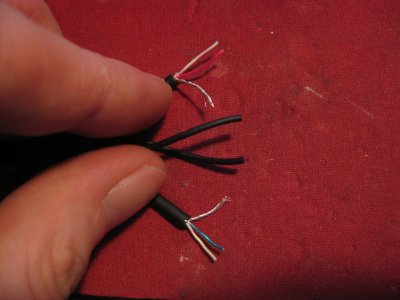

Try Canare L-4E6S, has two pairs and a shield inside, and more importantly its a very soft and flexible cable.  http://www.canare.com/ProductItemDisplay.aspx?productItemID=53
For the XLR to TRS adapters i just tied the two returns and shield connections together to the outer of the connector.  As a point of reference, the attached photo is a stock HD800 cable where Sennheiser have done exactly that onto a TRS plug.
I don't believe you need a shield for headphones, or can hear any difference with or without so i really wouldn't worry about it.
