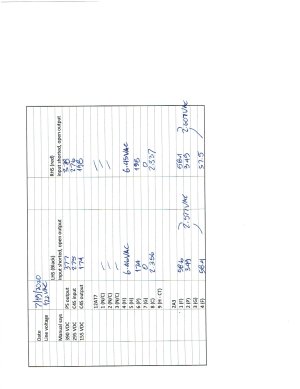

I'm attaching a copy of my voltage worksheet. Most of the voltages I measured seem to be okay to me. But the RHS CS4 output is significantly different from the suggested 155VDC. True the LHS is high, but it's only on the order of 12%. But the problem RHS is pushing 30%. Irrespective of the hum issue, is that a problem? Do I need to fix this?

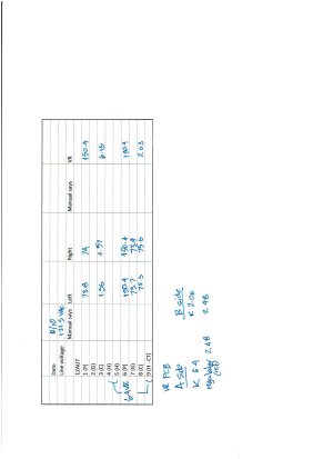

The over all issue appears to be the EFP3. I'm attaching the voltages from it. There looks to be an issue there in the voltage regulator. Since I don't know what the regulator voltages should be, that's only a guess. And I'm unsure of how to proceed to resolve this.
I don't know if this would cause a hum issue, but it seems to me that I need to address the improper voltage.
