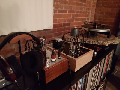

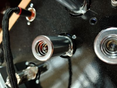

Just showing off my Eros 2! I finished Friday night, and spent the weekend spinning records late enough to screw my sleep schedule up worse than COVID already had. I am upgrading from a Hagertech Bugle2 that I built myself with Vishay resistors and Nichicon FG caps.
This is my second Bottlehead kit, unless you count rebuilding my Crack a few times as multiple kits :) It's paired with the Schiit Sol turntable. I rushed through the Crack and never bothered to make things look really good, a lesson I learned well for the Eros. I took my time to get things just right. I gave the top plate a glossy black coat, and the trafo cap, silver. A spritz of silver accidentally got onto the top plate, and I decided that actually, that looked really good. Both got a layer of glossy clear coat after that. The wood base is unfinished, but will be stained with dark brown 'kona' and Danish oil, and also finished with glossy clear coat.
Since this is my end-game, I wanted it to be beyond perfect, so I agonized over a lot of the parts selection.
  • For the power supply and shunt regulator wiring, I chose Neotech UP-OCC copper in PVC (20 awg). I made a twisted shielded pair to run from the AC inlet to the trafo and grounded the shield on the earth tab.
  • For the signal wiring and ground, I used a combination of Jupiter cryogenic OCC copper in cotton, and Duelund silver in cotton/oil (both solid core). For the ground 'strip' along the bottom terminals, I used Connex OCC 5N silver (sold bare). I also used Cardas quad-eutectic solder, which turned out to be fantastic stuff and so easy to work with.
  • I used upgraded tube sockets. For the shunt reg and output tube, I used Belton, and for the input tubes, I used some silver plated sockets. This was a dumb idea, because apparently not all socket manufacturers orient their pin layout the same relative to the mounting hardware... not a major issue, but some of the wiring is a little cockeyed.
  • For the RCA sockets, I used KLEI's top of the line low-mass silver RCA sockets. For the outputs, I chose DH Labs CM1 gold-plated copper.
  • I used matched boutique resistors for the 47kohm 2W and the 75kohm on the C4S board.
  • Awaiting a matched pair of Tung Sol EF806-S.

I saw this on Instagram and nearly commented that I have the same preamp and turntable combination but decided not to. I really like that raw piece of granite you’re using as a base.

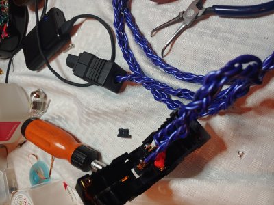

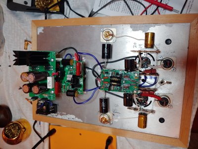

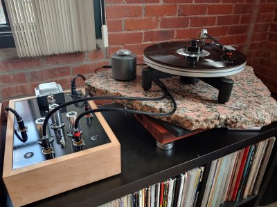

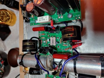

I have been slowly adding upgrades to my Eros 2, which I've attached pics of...
  • Bypassed output caps with 0.22uF Teflon caps (vintage Soviet FT-3)
  • Replaced shunt regulator 0.1uF capacitors with Clarity Caps
  • Bypassed cathode coupling(?) 100uF caps with 0.1uF Obligatto PPE film caps
I've been impressed with the upgrades so far. Teflon output cap bypasses are gloriously resolving and clear, and I was pleasantly surprised at how much difference the Clarity Cap upgrade in the shunt regulator made.
My system's preamp, Schiit Saga, has a 10kohm input impedance, which is too low to be ideal for the Eros 2. P.B. suggested that I could put 10k resistors across one of the Saga's inputs in another thread, for a 20k load. I went beyond that, I found a matched pair of 47kohm resistors last night and put them into a pair of dedicated Eros2>Saga cables, on the end of the cable which plugs into the Saga. The difference is... holy shit!! It's a huge improvement across the board, much tighter and cleaner sounding. I didn't get a ton of listening time in last night, but I was very pleased with what I heard.
Using those cables, I've got a minimum input impedance of 47kohm... so based on my calculations, I could get away with 0.3uF on the output with a cutoff frequency of ~10Hz. Given that my system is probably not even capable of going down to 20Hz, 10Hz is a perfectly acceptable cutoff to me (when I listen thru headphones capable of bass, I use my Crack with a 100kohm input impedance).... so this weekend, I will remove the stock output caps and replace them with 0.1uF Audyn True Copper Max capacitors. hat will give me a total of about 0.32uF, in conjunction with the FT-3 Teflon capacitors. I think this combo should sound very nice and I will definitely report back with photos and impressions once the caps have had a week or so to break in.

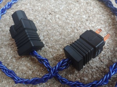

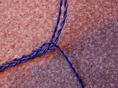

edit: another 'mod' was building a power cable, similar to the Bottlehead kit (in terms of braiding), but I used 20awg solid Neotech OCC copper in PVC, same as I used in the power supply wiring. I terminated it with some surprisingly affordable Furutech plugs with copper contacts, so that the power cable is high purity copper from tip to tip. This was originally intended for the Eros 2, but it ended up being so good that I ended up using it for my Crack instead. I haven't been able to sleeve it yet, so it looks like shit, but I'm going to have to eventually build another for the Eros.

I would still recommend 10K resistors and the stock value of coupling caps.

I suspected that might be the case.... but why? What's the problem with raising the input impedance to an even higher value?
    • Posts: 20250
Reply #8 on: September 25, 2020, 08:41:33 AM
The resistors you add are like adding output impedance to the Eros, which we don't want.  At least adding them at the passive pre avoids some cable capacitance issues, but not all of them! (don't ignore that most amps have some input capacitance as well as the cable capacitance between the passive and the amp) Add too much resistance and you risk treble response issues and you throw away potentially useful signal in the process.  You can also create noise issues by doing this, but you're still a decade away from doing that in my opinion.
