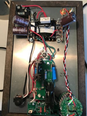

So i completed my speedball insert and i have a loud hum coming from both channels.  I went back and looked over both manuals.  I started by completing the basic build and it worked great for a year.  However after the upgrade i have the hum.  I noticed a few things my build looked identical to the picture at the end of the basic build. However, at the beginning of speedball manual page 15 the picture has different wiring on the power unit, different wiring and different color wiring. but there are no directions that state i need to rewire these things.  was wrong to assume that a prewired stock crack was ready to just proceed with the new components or do i need to rewire these things?  All of my measurements for the speed ball were with in the state spec of the speedball manual. i have also attached a pic of my build. I appreciate the help!

Is 16L soldered?
Offline Jimmye00
    • Posts: 7
Reply #8 on: September 02, 2020, 12:33:38 PM
Yes this goes
To the ground screw I believe?
    • Posts: 20305
Reply #9 on: September 02, 2020, 02:59:42 PM
Yes, it looked in the photos like maybe it wasn't well soldered.  Are there any other symptoms going on with the amp?  If that connection was bad, you might get a little tingle touching the chassis for instance.

Everything was perfect for a year prior to installing the speedball. So that makes me think it has to be something I did wrong in that area. When I was unplugging my headphones and touching the volume knob which is metal I could feel a bit of tingling electricity. I appreciate your help!
    • Posts: 20305
Reply #11 on: September 03, 2020, 09:05:10 AM
This is frequently not the case.  More often than not, the process of installing a Speedball may disturb connections that weren't 100% in the original build, then people will spend all their time debugging what is likely a working Speedball and not looking for what's actually gone wrong.
If you got a tingle from touching the amp, the chassis plate isn't well grounded, and that terminal I brought up looked poorly soldered.
