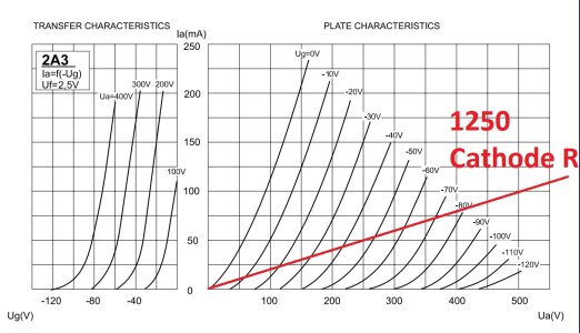

Another way you can analyze this is to assume that you have a 1250 ohm cathode resistor, then draw a cathode resistor line on the curves that indicates how much current the 2A3-40 would draw with a 1250 ohm cathode resistor.  I've attached such a line to this post.
    • Posts: 20340
Reply #2 on: October 06, 2020, 11:31:02 AM
So if you have that cathode load line up, you can see that with 325V of total B+ to work with, the 2A3-40 will settle with about 265V of B+, 50V of bias, and about 52mA of quiescent current.  That 265 and 50 doesn't quite get to 325 because I am allotting some voltage drop for your output transformer.
In order to determine where you would land on the cathode resistance line, it was just a matter of finding the spot where the grid bias volts and the plate volts added up to about 325.

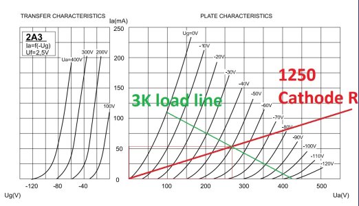

    • Posts: 20340
Reply #3 on: October 06, 2020, 11:34:46 AM
I added a 3K load line to your operating point here.  This should get you the typical 3.5W of output and would still work just fine with a normal 2A3 plugged in and will have a little bit of headroom on the positive voltage swing (but not much).
