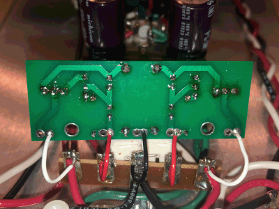

ps: If you need photos, I'll be glad to post them. For some reason they aren't uploading with this original post.

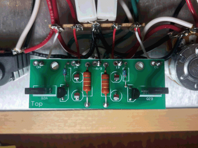

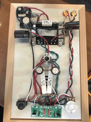

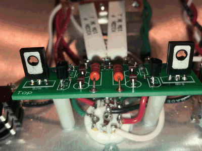

Reply #2 on: October 12, 2020, 04:39:01 AM
Thank you for your quick reply, Paul! I've attached photos.

    • Posts: 20300
Reply #4 on: October 12, 2020, 05:04:55 AM
I would reheat the joints on the small PC board.  I think you have plenty of solder on there, I'm just not convinced that the joints are well flowed out.

    • Posts: 20300
Reply #6 on: October 12, 2020, 05:15:45 AM
It is also completely possible that a prior build issue is just now surfacing after installation of the Speedball.  What I would expect to find in this case is a loose black wire somewhere in the amp.  A simple test you can do is to measure the DC voltage between terminal 12 and the black wire on the RCA jacks.  You can also poke and tug gently at the black wires in the amp with your meter probe while it's running to see if the small board randomly pops on at any point.
Offline Kaitlineddy
    • Posts: 5
Reply #7 on: October 12, 2020, 06:22:41 AM
So, I reflowed the small board and found a couple of iffy connections on the black wires where some of the insulation looked to be pretty close to the solder joint if not mangled in it (oops!). I tidied those up and now the voltages are checking out! Thank you so much for your help!! On to the large board!  :D
