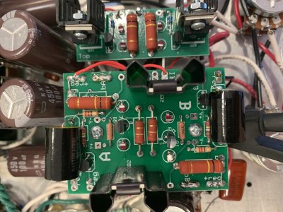

Can you post some photos of your build?  I wouldn't run the amp with 300V at IA/IB on the board you added unless by chance you have converted this to run 45s.  If you have 300V at IA and IB on the small C4S board, that would be OK.   Something is definitely not working properly here.  This is not a bad tube or anything like that, there's something touching that isn't supposed to or some kind of build issue.  Did the amp pass its voltage checks after the shunt reg driver update?

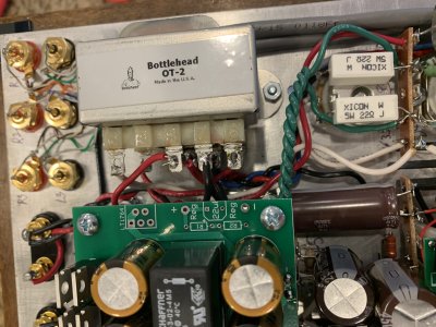

1. Terms 4 and 17, the results are in mV.  I'm attaching a photo of my retesting it (17 came back at 14.2mV this time).
2. So I was testing the small board (oops) - I tested the big (correct) board and IA / OA / IB / OB all came back fine (391 / 299 / 392 / 301).
Attached are some photos.  The only changes I've made since the original build I did was rewire the OTs for 4 Ohms.  I did all of the tests once I did the installs of the upgrades (which I did on different occasions).

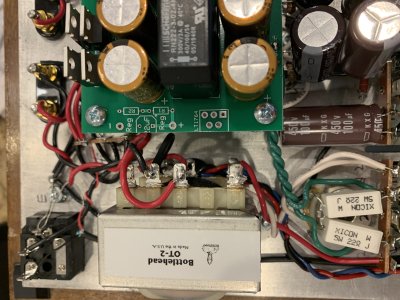

Offline lskiii
    • Posts: 49
Reply #3 on: October 18, 2020, 06:12:32 PM
Additional photos
