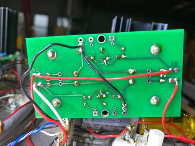

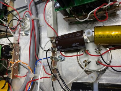

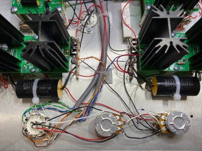

Could you post some build photos?  Also what is the date on the PDF of your manual?
Offline markamon
    • Posts: 14
Reply #2 on: October 20, 2020, 11:10:28 AM
The manual is the October 22, 2014 revision.
Attempting to post some photos especially of the terminal 12 area.
If you can let me know what views are best I can work on that.
Thank you,
Mark
    • Posts: 20302
Reply #3 on: October 20, 2020, 11:55:34 AM
**12- 0
Can you double check this one?  This should just have the resistor, cap, and CAT5 connected to it.
**A1-  600 ohm not stable
**A4-  4.2 ohm
A4 looks like one wire may not be well captured by solder.
**B2-  65 K-ohm
**B4-  600 ohm not stable
I wouldn't be so worried about B2, but B4 is concerning.  Perhaps in the photo what I'm seeing is B4 that's not well soldered rather than A4.

It is very unlikely to be the resistor.  You could have an error back by the RCA/XLR sockets that is causing this, like say solder shorting the RCA output jack on that channel.
    • Posts: 20302
Reply #6 on: October 21, 2020, 06:55:19 AM
For the B4 issue, are you 100% certain you have the socket installed in the correct orientation?  If the fat pins aren't in the back, then you'll end up with some issues.

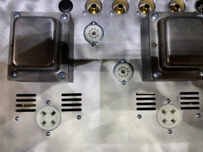

I attempted to attach an image showing both of them, if you can verify.
Thank you!
Mark
    • Posts: 20302
Reply #8 on: October 21, 2020, 08:24:09 AM
With the 300Bs plugged in, A4 and A1 are shorted together by the 300B filament, which will be under 4 ohms with a cold tube.  You are seeing the correct resistance on A4 that is the filament bias resistors going to ground.
Now I'm noticing that you have the same resistance reading on A1 and B4, so this may simply be your meter unable to cope with the big cap that's there, so I think you can ignore this for now.  If there is an actual issue, it will become very apparent with the voltage checks.

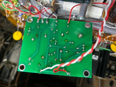

I have had a chance to look for bad soldering, re-soldered several questionable joints.
I seem to be making things worse, as I started out with only questionable voltages on the B side, now I have issues on both sides.
I discovered or created at least two new problems.
First new problem- the two LEDs on the B-side C4S board closest to the rear of the preamp do not come on now. Before my re-soldering all the LEDs came on.
Second new problem, the four LEDs of the  A-side go dead after about ten minutes, when it gets hot. Very repeatable. Swapping the 300B tubes does not alter this behavior. Turning the power off and letting it cool down restores functionality and voltages  to the "A" side. The A side comes on reliably from a cool start, and the voltages I obtained below are when the LEDs are on.
