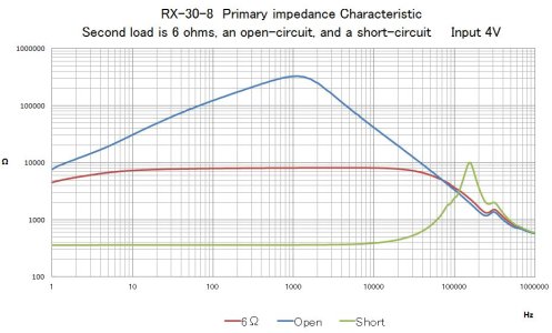

But I often listen without a parallel load resistor across the secondary -- i.e., with nominal 3.3K:64R loaded by 200 ohms phones that gives me approx. 10K primary impedance.
I have pointed out repeatedly both here and on another forum to you that this is not accurate.  I will again attach a measurement of a transformer that demonstrates this.
« Last Edit: October 22, 2020, 10:14:10 AM by Paul Birkeland »
Well, I figured that only applied to a truly unloaded secondary. But I am now reminded of a comment by PJ some months ago to the effect that with a normally loaded secondary you can usually ignore the primary inductance, but not so with a lightly loaded one. I think I've since *learned* why (well, I still need to figure out the theory/math behind it): with sufficient current through the secondary a tiny "shunt inductance" is reflected in parallel with the primary self inductance which renders the effective inductance of the primary negligible, leaving only the reflected load from the secondary -- i.e., the nominal/spec'ed primary impedance [edit: assuming the secondary has its spec'ed load]. What I don't know, but hope to figure out in the next few weeks, is the amount of current needed to achieve this. I would have thought that if the reflected "shunt inductance" is proportional to current through the secondary, then the smaller the current the better.  But PJ's previous comments suggest that this is not so. More to learn!
