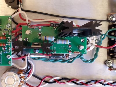

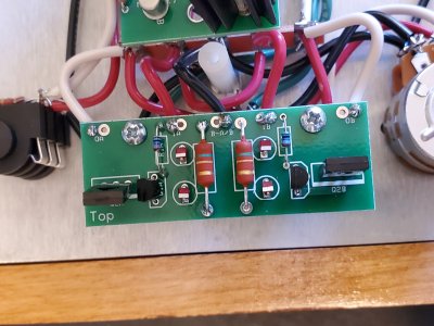

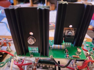

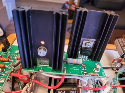

Typically I would expect to see this problem when the mounting hardware on the TIP50 transistors isn't installed properly, or if there are soldering issues on the bottom side of the big board.  You might want to pop the wires out of one side and flip it over so we can see if there are any solder bridges shorting things out.
It's also not ideal to have the 2N2222 transistors touching the board, so if you can heat those joints up and just move each transistor a tiny bit off the board, that's not a bad idea either.
    • Posts: 20295
Reply #2 on: October 25, 2020, 08:19:24 AM

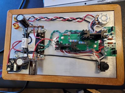

A4 also doesn't look like it's well soldered.
    • Posts: 20295
Reply #3 on: October 25, 2020, 08:21:00 AM
The wire leaving B2 and going to the front of the amp needs to be crimped around the socket pin and resoldered.
    • Posts: 20295
Reply #4 on: October 25, 2020, 08:22:11 AM
The black wire on the volume pot that goes to the center lug of the 9 pin socket also needs to be crimped on the pot lug and resoldered.
