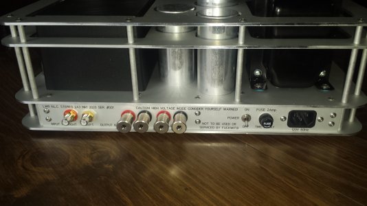

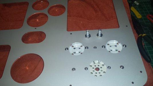

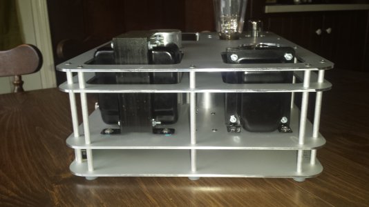

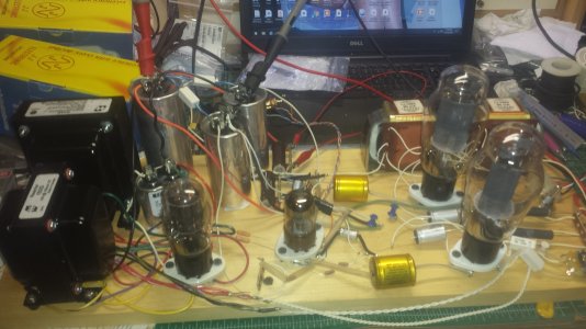

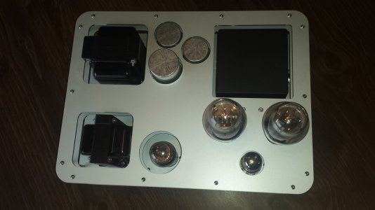

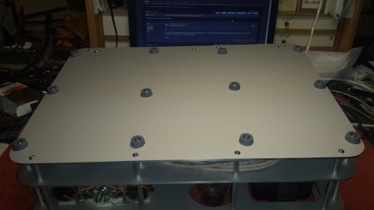

Hello, a while back i built a modified Foreplay III in a design fashion of a gentleman by the name of Don Garber who built a line of amps and preamps in New York City. I have always loved the aesthetics of his designs so i decided to build a stereo 2a3 amp to pair with that preamp. And this is how the story go's . I started to design the chassis plates and ordering parts on august 15th 2020, i spent 2-3 hours a day, often times more designing on Front Panel Express. As the parts started coming in I started to breadboard it. I had to wait for the Lundahl opt's but they eventually arrived, joy. I then realized that i had a problem with my understanding of operating points and PB was quite helpful in getting me squared away, Thank you PB! So after that my plan came together and this amp sings Beautifully, I have never had or heard a 2a3 amp before but it startled me on a first impression, I love it. Enjoy the pic's
