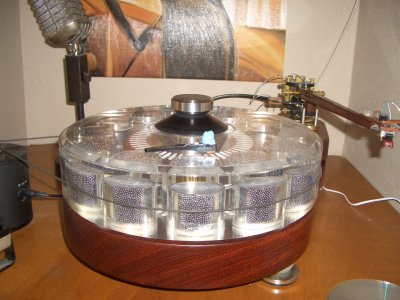

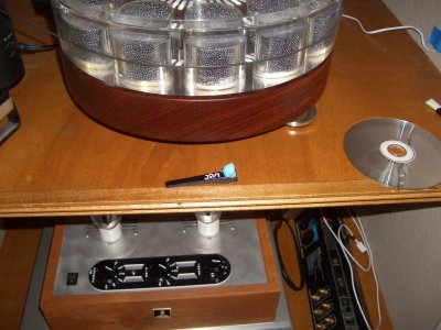

I have used some blu-tac on the bottom side of a
LAST stylus cleaner for a couple of years now and it works very well. I simply lightly press straight up onto the stylus and it removes all matter from the stylus without leaving any residue. I occasionally reform the blue tac to "clean" it.
Here are a couple of Pics.

Is that a Soundsmith needle on your Grace F-9?
For stylus cleaning I am mostly dipping in the Magic Eraser but also dry brushing with a Last style brush and once in a while I use the solution from the Disc Doctor which has minimal or no alcohol. I have used the Onzow as well and the Blue Tack. They all work well. I inspect my styli under a special DIY modified microscope which resembles the Shure stylus microscope. When using the magic eraser method and the records are clean that seems to work very well. When records are dirty the Magic Eraser gets to its limits though. Dipping after each side is essential otherwise dirt accumulates and then the dipping does not remove the crud only brushing with solution does. I have not done this inspection with the Blue tack method, should be an interesting comparison.

Yes, it is a Soundsmith ruby cantilever stylus. I had wondered for some time why Peter only made a replacement stylus for the Grace F9 cartridge. He is a master at rebuilding cartridges with a new stylus but only builds a complete stylus for the Grace F9. I had used a number of different moving coil cartridges over the years with a Bent Audio step up transformer.
My curiosity got the best of me and I bought one of Peters stylus for a Grace F9. No extra SUT in the line now and the sound is excellent. I am well satisfied with it.
