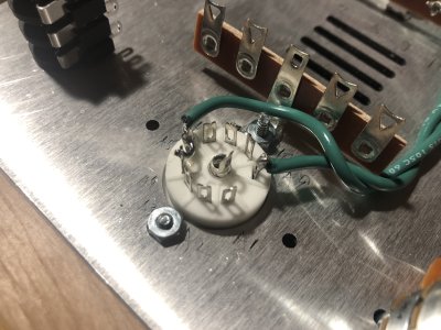

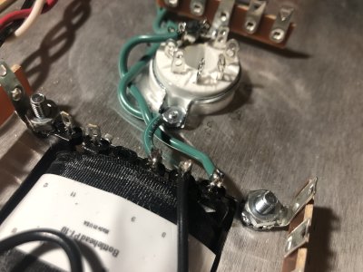

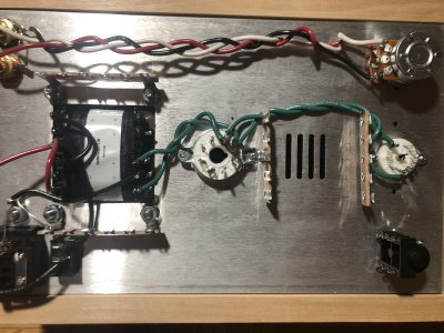

Hi sorry was cooking. Theres where I'm at and some close up of the joints, a bit messy looking from redoings.

The wires on the octal socket are not soldered.  They are also not crimped to the socket contacts.
Crimp the wires tightly, solder the crimped parts to the socket contacts, then you should pass the glow test.

Aight I redid all the connections, still no glow but then I noticed the red wire on the power cord socket is detached. Maybe is from one of the flippings. But yeah now I finally got the warm glow. Thanks!
