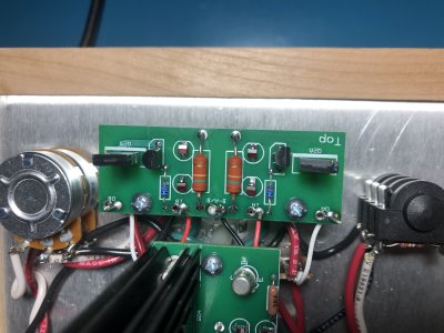

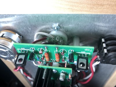

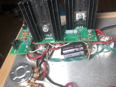

Hi, I just added the speedball to crack, and everything is fine. All 10 leds light, everything measures normal except what I mentioned. I'll post the voltages below. I measured the resistance and voltage on crack again before adding the speedball and everything is normal. Thanks!
Crack
1. 84
2. 179
3. 0
4. 178
5. 89
6. 0
7. 108
8. 0
9. 112
10. 0
small board
OA. 75.5
IA 187.5
BAB 0
IB 187.3
OB 85
large board
OA 113.7
OB 107.1
G  0
B+ 182.2
« Last Edit: November 15, 2020, 06:53:06 AM by Paul Birkeland »
