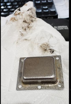

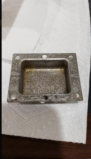

Hi Everyone,
I got my kit yesterday and rubbed mineral spirits over the top end of the steel bell end. I didn't clean the inside with mineral spirits. After running it through the dishwasher, it came out looking like the pictures I've included. I've been able to get some of the gross looking stuff off by scrubbing with a paper towel / soap and hot water plus a sponge.
I've seen in the forums that Barkeeper's Friend is suggested to get rid of light rust. Can that help here? Since the bell end is just raw steel, I should still be able to use it, correct?
Thanks for any help,
Cornelius
Cornelius

Reply #1 on: November 14, 2020, 08:28:35 AM
I had tried to search for this in the forums earlier and didn't find anything, but google search came up with this post: https://forum.bottlehead.com/index.php?topic=8178.0
Seems likely the dishwasher pod that I used corroded the steel a bit. I'm going to go get some steel wool and buff out what I can, then continue my build.

Reply #2 on: November 14, 2020, 08:39:17 AM
Why did you put the cover in the dishwasher?
I would sand it down inside and out until there is absolutely no rust on it, then clear coat it with lacquer.
Offline Natural Sound
    • Posts: 998
Reply #3 on: November 14, 2020, 08:42:34 AM
You should get as much of the rust off as you can and give it a couple of coats of spray paint. If you don't it will rust again.
FYI - I usually use some Dawn (the blue dish soap) and a scotch-brite pad to clean the bell end prior to paint.
Offline Deluk
    • Posts: 441
Reply #4 on: November 14, 2020, 08:51:57 AM
Cover it in a dish of white vinegar over night to remove the rust. Wash under the tap and dry it. Not in the oven or it will flash rust again. If you are going to paint it give it a couple coats of primer to protect it. Hammer paint can go straight on and there are also other paints that don't need primer. Have a look at the Rust-Oleum range.

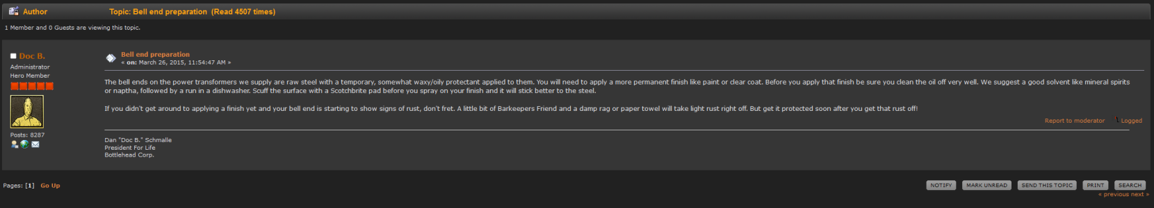

I read that a run in the dishwasher was suggested for the steel bell end in a pinned post under General Discussion titled "bell end preparation." I've included a screenshot of the post here so no one has to go searching and clicking. I'm not blaming anyone for the minor scare - after all, I was the one who put it in the dishwasher.
I'm planning on first using steel wool and 400-600 grit sandpaper to get the rust off, then spraying clear coat lacquer on both the inside and outside of the steel bell end to prevent future rusting. Should the steel wool and sandpaper not work, I'll submerge it in white vinegar overnight as suggested. One more question for now: I don't need to worry about a clear coat on the inside of the bell end cover affecting the grounding of the transformer because the bell end is still basically naked steel, is this correct?

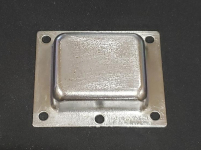

Update: Grade #3 Coarse steel wool did the trick! Scrubbed off the rust. Now it's infinitely better than what came out of the dishwasher this morning. Will soon spray both sides with the clear coat lacquer and continue with the build. Thanks so much for all the responses!
Cornelius
    • Posts: 998
Reply #8 on: November 14, 2020, 01:42:54 PM
Good job! It looks great.
