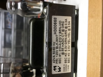

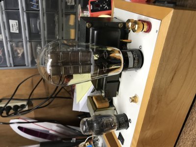

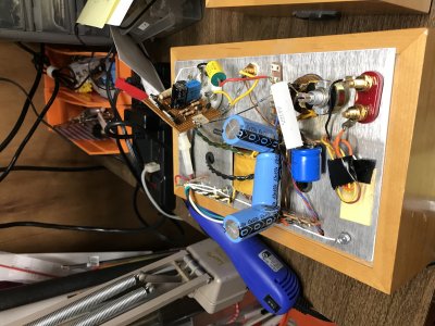

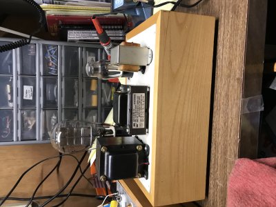

Pardon the condition, as these where a buck to run mods on. The 300B are the 2.5v type. Sorry the attachments rotated on their own. The power transformer is a Hammond H300668.

« Reply #6 on: December 01, 2020, 11:27:33 AM »
I would electrically leave everything alone and just run the TFA-204 in place of the stock plate choke.  The stock plate choke can replace the 270 ohm power supply resistor.

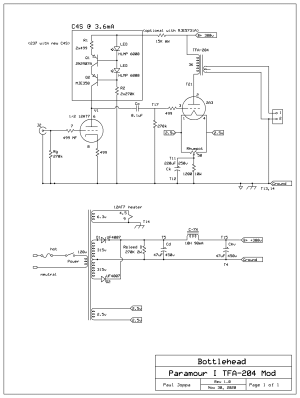

« Reply #7 on: December 01, 2020, 11:30:02 AM »
OK, that was an original Paramour version 1.1. There seem to be other mods, notably the perf-board which I presume to be a current source but not one I recognize.
I have modified an older file to show the schematic for the TFA-204 modification. I did not include changes necessary for the 76 driver - mainly the cathode bias resistor.
Because of the limitations of the power transformer, there are not many options for other operating points.

« Reply #9 on: December 01, 2020, 03:27:40 PM »
First of all thank you guys so much for the information. I now have what I need to decide where to go from here. I prefer not to max out the power supply as I feel head room there is a big plus. One of my 300B's was broken in shipping and I cannot justify the cost for a new one. Yes Paul you nailed it, the perf board is a Constant current source. My speakers are very efficient, room is small and my hearing is still pretty good so I am not trying to get max wattage only one or two really good watts is all I need. I am totally impressed that after this many years I am still getting valued support !  You are all AWESOME!
