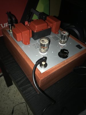

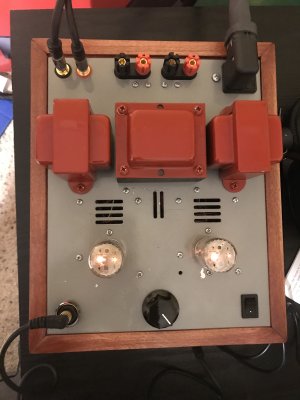

Finally I finished my S.E.X build.. It sounds good so far. I was planning to let it "burn in" over a few days and then try the stock kit and put in the C4S upgrade later. Does the C4S upgrade make a huge diff. to the sound (like Speedball does to the Crack)? I had one question around the stock kit. Is it OK. to try out diff headphones while the amp is running? Does it harm the amp to run with no output?

Reply #2 on: December 01, 2020, 03:57:50 AM
The finish on the base compliments the paint on the Transformer bell and Plate Chokes. Nice work.
Online Doc B.
Reply #3 on: December 01, 2020, 08:35:12 AM
Nice color on the iron.
