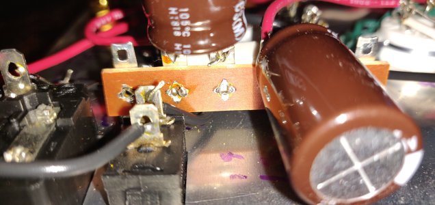

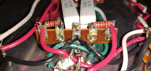

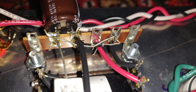

Could you post some photos of your build?

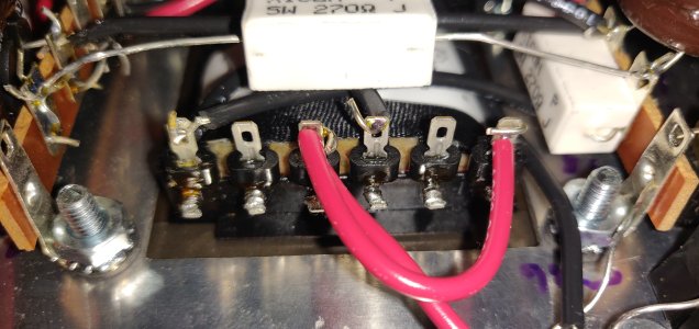

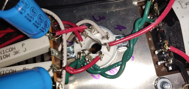

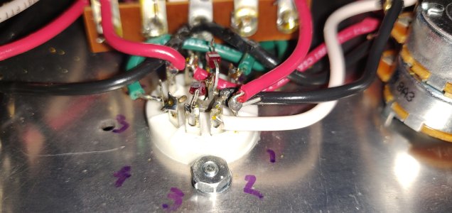

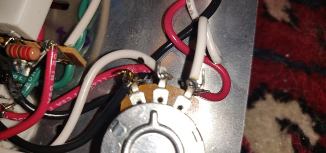

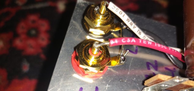

Reply #4 on: December 02, 2020, 03:56:34 PM
I've attached the photos. If you want better pictures of any specific part please let me know.

    • Posts: 20348
Reply #5 on: December 02, 2020, 05:08:48 PM
You need way more solder on your joints.  You also need to heat the joints longer to let the solder flow out.  Out of curiosity, what kind of solder are you using?

Reply #6 on: December 02, 2020, 05:31:17 PM
Thank you! I'll get started soldering again tonight and let you know how it goes. I'm using 60/40 with rosin core. I think I got it from ace hardware back when I first built the Crack.

Reply #7 on: December 02, 2020, 06:24:25 PM
I can't thank you enough! It's working and sounds better than I remember. Thank you so much for helping me out with this! I was at my wits end trying to figure this out on my own but am ecstatic to have it working again.
