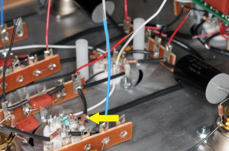

Hi.
Few days ago I bought Eros 2, downloaded manual and read it this weekend. I find out, that resistor 90R9 resistor, connected to EF86 anode is not on schematics (page 7). Instead, acc. to schematics, there should be just piece of wire. Where is mistake - in schematics or further in manual?

Reply #1 on: December 06, 2020, 10:40:06 AM
Yes, I put a plate stopper on the EF86.  I would recommend following the instructions in the manual.
