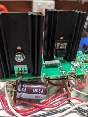

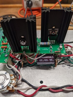

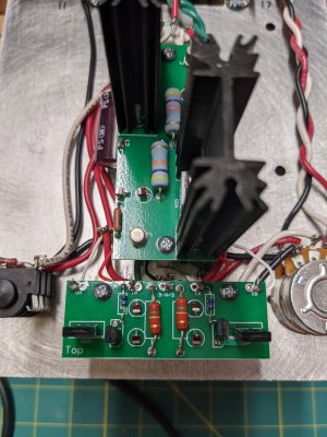

Ive had a working crack amp for the past fortnight and decided to add speedball - everything checked out however once powering it up im getting loud static that is present when the volume is at 0% the buzzing after 10 seconds from power on is too loud to attempt to listen to any music with.
All Leds are alight (4 + 4 + 2)
Both tubes are alight
Resistance checks for speedball large board were OL on my unit
Large Voltage readings
oa 108.8v
ob 102.6v
g   0v
b+ 171v
Small Voltage Readings
oa 68.1v
ia 171.2v
b-a/b 0v
ib 171.1v
ob 79.4
Tubes are the supplied tubes
Any suggestions on where to start troubleshooting? I have reflowed the U1/2/3/4/5 and U7/9 along with the oa/ob/ib/ia's
Thankyou
« Last Edit: December 07, 2020, 04:39:33 PM by barbz »
Offline barbz
    • Posts: 19
Reply #1 on: December 07, 2020, 01:10:00 AM
Some photos
Offline oguinn
    • Posts: 914
Reply #2 on: December 07, 2020, 05:15:03 AM
You need more solder on the big board. I can see a couple spots on resistors and LEDs where the solder hasn't covered the pad.
Also, if you're not passing your resistance checks, don't plug headphones into your amp.
Jameson O'Guinn
    • Posts: 20258
Reply #3 on: December 07, 2020, 05:38:30 AM
Buzzing would be something other than the Speedball that's loose.  You can plug in an inexpensive set of headphones and poke at the amp while it's powered up with a wooden chopstick to see if you can change the behavior of the amp by poking it in a specific place, then that can focus your efforts.
