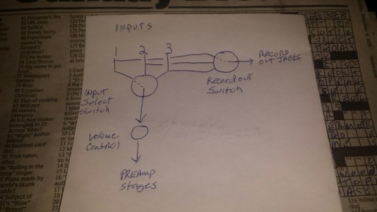

You could tap into the inputs on your preamp either at the input jacks or the input selector switch and run them to a record out switch
that you install. That way you can select what source you want to record and also what you want to listen to while you record.
The lousy drawing i did shows a preamp with 3 inputs and on the right the record out switch.
keep in mind I only show one channel and no input grounds to keep it simple.

Thank you both for your input. Both of you are on the same track with the connection before the volume control. Well I now have a new project to do! Thanks again guys!
Yes, this connection must be made before the volume pot.
