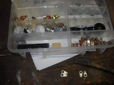

Happy New year! The base is glued and will be adding corner blocks after the chassis is populated and I can make sure of clearance. An early observation is the location of the ground lug between the volume and balance (page 11) however (page 56) shows it between the balance and input selector to accommodate the lead dressing/wire routing. I guess that is 6 of one half dozen of another. One other comment, I lightly took a wire brush the the ground lugs to remove a bit of oxidation. This will make sure of a better contact with the chassis and make for a better solder joint. I also light clean the oxidation off all component leads with some plumbers sand paper just try not to take it down to bare copper. I like to have nice shiny leads so the solder sticks. Tinning the leads of the wires is also important. I learned soldering here in Wichita building aircraft avionics. I know that we are not building rocket ships here but I am very picky about soldering and will be more than happy to answer any questions. Also, give those nuts one last check before you start soldering. It is much easier to check for tightness without them being wired up. A loose ground could really give a person a headache. Sorry about the huge pic file. I will do better next time
